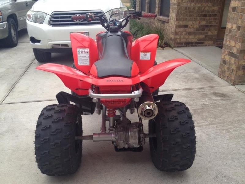

***BEFORE PIC:

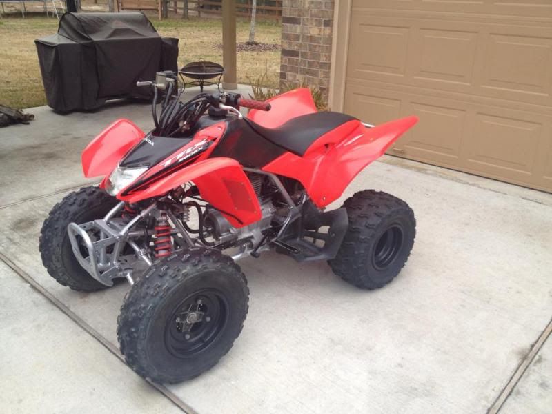

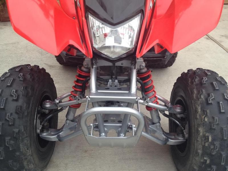

***AFTER PICS:
The important thing is that my kids seem pretty happy with the results. B) Let me know what you think.
