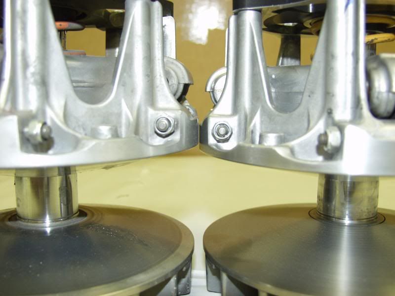

Spidermod Clutches are Identified By the recessed Faceplate and the Exposed Fixed Sheave thru the front cover. They are available for Both Stage 2 sheaves and Stage 3 Sheaves.
What is a Spidermod?? What does it do?? What the Spidermod Does is Give the Clutch the ability to run Lighter weights and have them function as heavier weights. The Spidermod changes the Fulcrum point as to where the weight contacts the roller VS Sheave position. Meaning, the Sheave moves Less, moves faster, and gives more belt travel. Spidermod also DECREACES belt-sheave gap to Less than stock Specs.
This gives the Atv more Lowend and is a Dragrace Oriented, Sled Pulling, and Stock Class Gncc Modification. this Clutch is smoother and lighter than the normal Stock Spider clutch machining.
Fuel economy is Increaced by 15-20%
here you can see a Stage 3 VS a Stage 3 Spidermod Clutch Sheave for comparison

Teryx Clutch Modification. Price is 350.00 KEBC bearing Removal is Recomended.
The Teryx Modification is different from the V and Ute Modifications as the Teryx Clutches are thicker and vastly different from the ATV clutches we have come to know. The Clutch is modified More than a Stage 3 Clutch. the Teryx needs ALL the overdrive gearing we can throw at it.
They work, 84 MPH gearing, 42-45 low range gearing, Higher top speeds, Far greater low end, and far better belt grip.
This is 100% different approach compared to any bolt on clutch components on the market.
VFORCEJOHN CUSTOM SPRINGS AND ADJUSTABLE WEIGHTS ARE AVAILABLE AS OF 4/20/2010
Comparison Pic of Teryx VS Bruteforce Clutch. They are NOT atv clutches, but very similar.
Dalton Teryx clutch VS Stage III Teryx clutch with dalton cover, weights and spring
Yes, the Dalton components can be enhanced for even better top speed and performance.
Dalton clutch VS Stage III Teryx clutch. Less sheave-belt gap = better initial belt grip, more travel = higher top speeds, more overdrive, lighter clutch assembly, and even more fuel economy.
Teryx Full race clutches loaded with Dalton faceplate, spring, and adjustable weights.
What I do is Clearance the Sheaves, Modify the Sheave angle, Modify the Spider, Modify the faceplate and remove the KEBC.
Modded Stock Teryx Clutch
Teryx Sheave modification
9.4 pounds after the modification. Removes OVER 1 pound

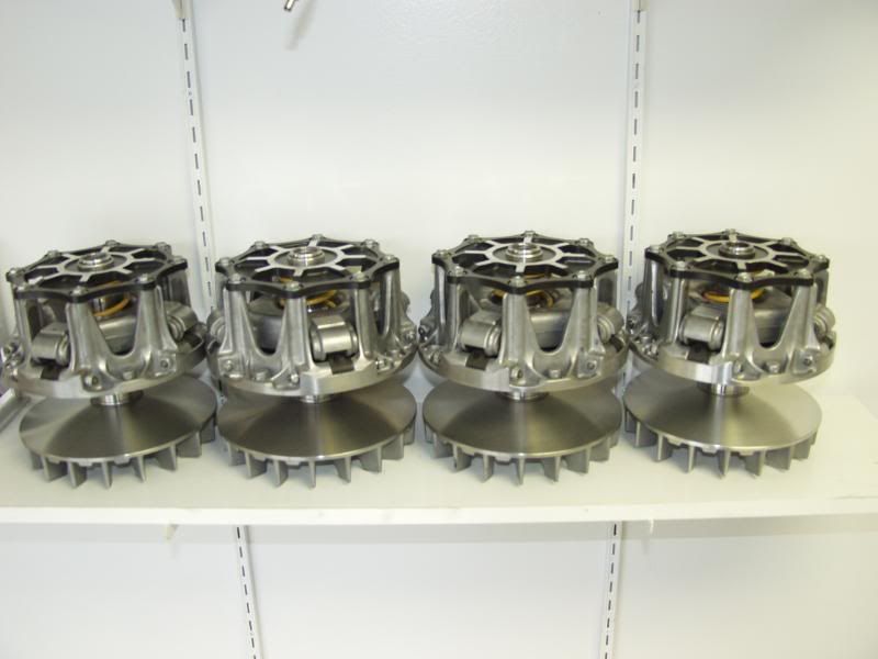

all secondaries were done the same post up a pic of it.
these are the only 2 other pics I have here.
but I do them all the same. didn't change them
Quote:
stage 4? and my milled secondary looks different... I guess you stopped taking so much off of them? [/b]
I need a pic of the Stage 4.
I don't have any here. I think you have the OLD stage 4 with the fins on it
this might even be your clutch or 1stquads old one. I don't do them thisway anymore
