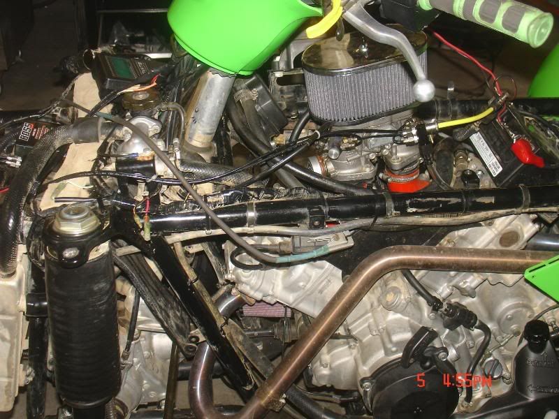

I installed one last week. it went on in literally 1/2 hour. I cut off the switch and the push button and wired it right to the override button wires, then, I wired the power and ground to the horn wires. hook up the lines and fire away.
tuning was easy as well. I tee'd off the fuel line to an inline thumb screw fuel regulator (from the old boss noss kit) and with in 5 runs and turning the a/f I had a nice solid a/f line at 12.0-12.2 a/f
The claimed 30 shot was exactly 15 to the wheels. on a ported stage 3 cammed 800. we ran it many times and it gave perfect consistant results.
it went in the webers and fit very nicely drilled and tapped. and just incase you ever need the tap # for the boss noss it's 3/8-24 NF.
