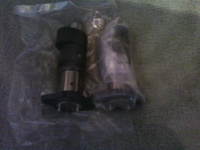

Have a set of brand new Fundy (new style) UTK trail cams I'd like to sale or trade. I have been told these cams are good for 52 rwhp and can be ran with Wiseco or JE pistons.
I would guess with all bolts-ons Muzzy or LTE, UPP, 12 hole, ect that you could get more HP out of them. They have "ZERO" hours on them. HD or Kibblewhite valve springs are not required with these cams. $315 shipped plus 3%
Will trade for a set of new or low hour Fundy race cams or CWR Mach 3 also known as 418's I do not want FST or AMR
