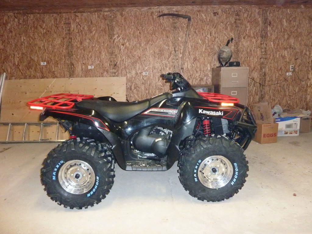

Here is my front moose on my 09 750, Hard to tell in the pics but the bumper fits up close to the factory one, a very nice piece, and it feels solid, does not move without the quad moving.

Love my new Moose bumper, even fits with the ricochet skid plates that i just installed.
that looks sweet, i have the camo brute and same wheels, i havnt tried the bumper on mine yet gonna get one soon

I have 25" Bighorns(origional not to 2.0) and the moose bumper on mine and I can still wheelie no problem. Lost about 3km/hr top speed witht the tires though. Fixed it by adding the dynatek CDI.
