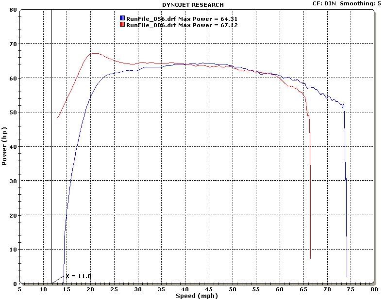

finally figured out the damn fuel injection. it took about 175 dyno runs (so you know this motor is well broken in) and 4 days of 10 hours a day screwing around with different things.
I ended up with this. I stopped the runs at 60-65 as I was just interested in low end tuning at this point. 67.4 rwhp

this chart compares his previous setup stock motor with muzzy std and EHS Dobek FI controller and stage 3 clutch with maroon spring.
Here's the comparison of no moose module VS installing a moose module from a CDI/carbed prairie/brute. I cut and spliced it into the EFI computer to override the timing settings all the time. Damn it worked for the low end that was missing.

there was a ton of Map sensor tricks and Idle control tricks that I had done/tried to make it work better. leaving everything that controlled the FI stock (map sensor, temp sensor, IAC control unit) I had it to a best of about 59 rwhp. what would happen is the map sensor voltage would change drastically with every revolution of the motor. not at idle, but just off idle. it would read max lean, max rich about 25x per second causing the computer to blunder and just flood it with fuel causing the lag. but I figured it out.
