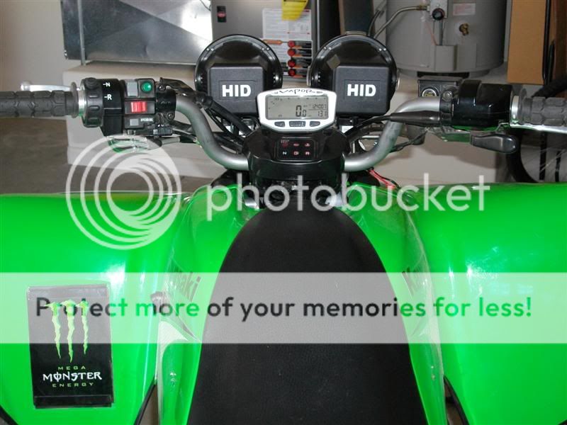

I had one of these HID's on the V and it was plenty---Way better than stock---But that was only drawing 35 amps---So I decided to put 2 of em on---Just got in from a night ride and wow---It's unbelievable how good this worked---What I did was take an old beater hood---Rigged up the lights on the hood---So in less than a minute I can change hoods, ( it's totally plug and play )---That way I can preserve them from all the bumps during the day---Here's a pic
This was with 1 HID and 2 extra small lights
Here's with the 2 HID's--They are Euro---Flood/Spot combo
Just a pic from the other side

An old beater hood---A few dollars at hardware store---The lights I got at Kragen/O'Reilly---I paid $99 for one and $109 for the other---They go on sale off and on. Yeah they light up the park for sure.
When I get time I'll put up a step by step in the Mods section---It does look nice---But really doesn't matter as it's only used at night--That's why I used an old hood.

You guys are missing the point----Appearance doesn't matter here--They're used at night time only, (it's dark).
The point is not having to trash your expensive lights with rough daytime riding----They're built into a separate hood which is used only at night----Totally plug and play and change out time is 1 minute.

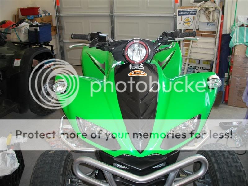

Hmm---Sparks NV---Maybe the booze from Vegas has gotten in your water system:p---Actually I picked them up at WallyWorld---I painted them gloss black and added chroming vinyl--They are 55w Halogens--Drilled 1/2" hole and smaller one behind it for wires---Small piece of black electric tape over both holes, cut a slit in tape---Put light and wires down through holes---Got wing nuts to tighten from underneath---Best to get an extra set of stock wires from light to power---That way they are plug and play---And you can use either those or stock--Takes seconds to unplug one and plug the other in.

That's a good question---I thought for sure they would---I put a small strip of stick on window insulation on the bottom of each and a large flat washer, lock washer and wing nut underneath--I was shocked at how those little suckers held--Never had to tighten that wing nut again--And they took a beating on some rough trails, through the ruts at the dunes, even ran into a riveen about 6' deep at about 40mph---Thing is though I never used them--Never fired them up as I went to the one HID instead---Just left them on the fenders cause so many people with GOOD TASTE:p liked em.
