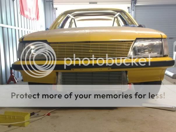

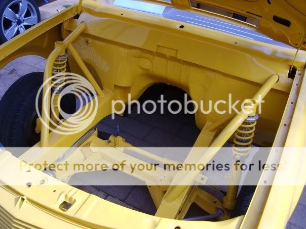

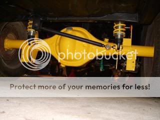

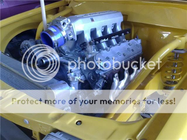

this is my holden 1981 commodore before this build 4th one it weighed 2450 lbs it ran 9.40 with a roller 400 chev in it
this build has a ls1
9.1 comp j.e forgies
turbo grind comp solid roller
ported heads
pro flo manifold 90mm fast throat
5500 convertor transbrake t-400
9 inch 40 spline mark williams axles
1000hp garret bearing turbo
hoping for around 800rwhp
and to weight in around 2150 lbs should be a fun ride hoping for a low 8 sec pass:D will sort some pics out

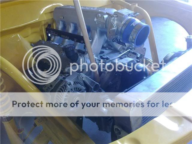

What turbo is that? T-76?
2,974 Posts
Discussion Starter · #12 ·
t04z bearing its been modded with a different exhaust housing and been high flowed i bought it from turbotech here in aus its been set up to run 1000hp
80 Posts
A t04z that blows 1000 hp seems a bit high,800 would already be strong imho. You would need a gt 42 rs for that
2,974 Posts
Discussion Starter · #14 ·
its rated by turbotech at 1000hp if it makes 700hp im stoked last gt42 i had failed and flew apart

Nice job..
I see you changed the shock mounts,from the first pics.
4,528 Posts
wow,that outta be a handful!.psi do you have a turbo on your lawn mower too:p
2,974 Posts
Discussion Starter · #17 ·
yeah first shock mounts were for strait line 1/4 mile ive decided to street drive it so i changed the upper mounts ive also just finished my toy hauler aswell 1998 toyota hilux converted to turbo getn tuned today:D
