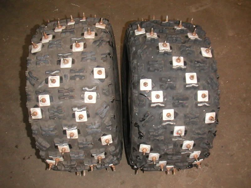

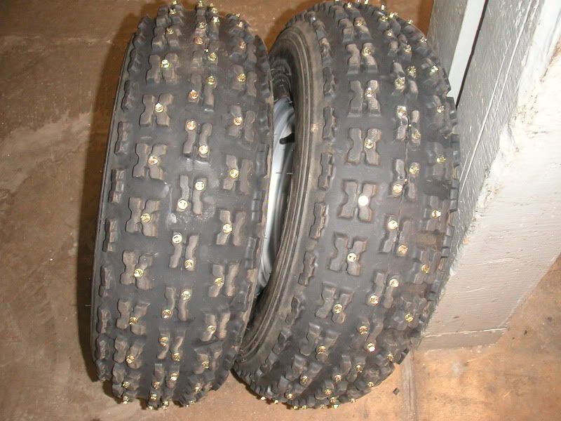

I just finished my set of front/rear tires for ice/snow for when I play on the lake at a friend's house. They do mostly drag racing so I figured snowmobile studs would work the best for the rear instead of the Turf Tamers with screws that I had originally set up (especially if there is any snow on top of the ice). Each of the rear tires has 56 carbide-tipped Woody's Gold Digger snowmobile studs (that I sharpened before installing). The front tires each have 120 Pro Gold ice screws in them.
Finally found something good to use the stock Holeshot tires for! :lol: :D

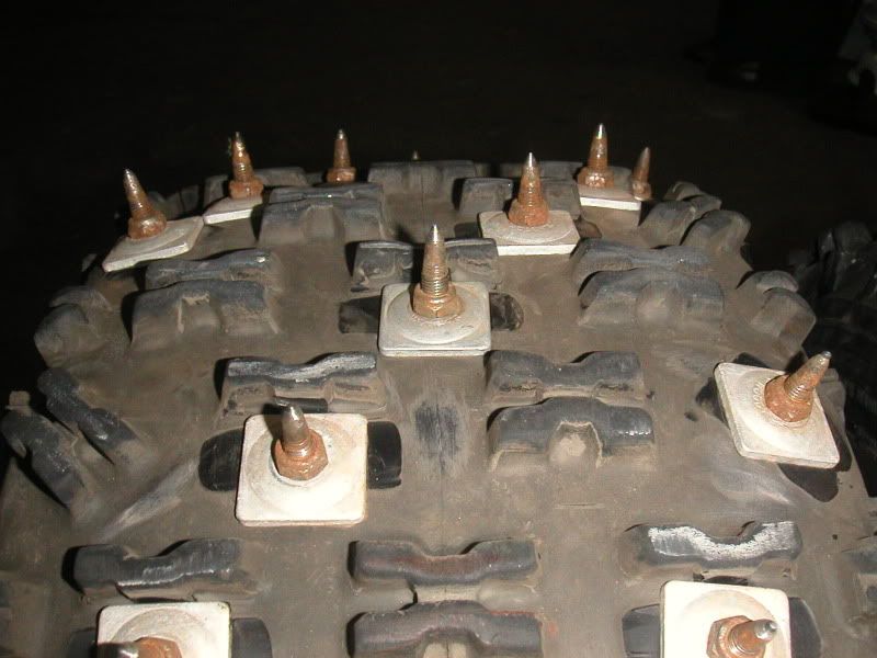

They are size 1.075 Woody's Gold Digger carbide-tipped snowmobile studs (you have heard of snowmobiles, right monkey?:lol:). The actual overall length is 1.485". The tires I put these studs in had about 1/2" of tread remaining and the studs stick out past the knobs by 5/8" - 3/4". I bought used studs off craigslist because they are so expensive. Expect to pay $200+ for new studs/nuts/backers.
http://www.sled-parts.com/woodys/application_tips.bmp
The most common brands of snowmobile studs are Woody's and Stud Boy if you want to do a Google search.
The stiffness of the tire is part of the reason I used my stock Holeshot tires since they are a flat profile and very stiff (6 ply). I put some thin, flexible fiberglass (indestructible) matting in the tire and then a tube. At 10 psi, you can't really flex the studs by hand at all.
