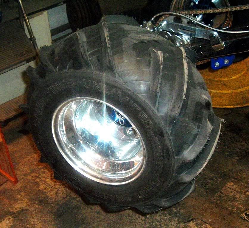

You will find that the best sand performance is from using a tire that is taller than your 22" A/T tires. Most go for a 24x11-10 8 to 10 paddle tire for the sand.

I don't care what size the jockey of the quad is these KFX's need AT LEAST 24" paddles.

Dave at Fullerton Sand Tires says teh same thing the 24" are the Ticket! now to go either Edges or Haulers for the wifes Quad, he like to put them on 10" wide rims, I hate 10" rims, Pro: Great Floatation, Con: Sand Can Get into The Bead, have to silcone the edges.
I run 9" on the DS and the LT500, Like to see how a set of Comp Grooved SS would work on the V700.
