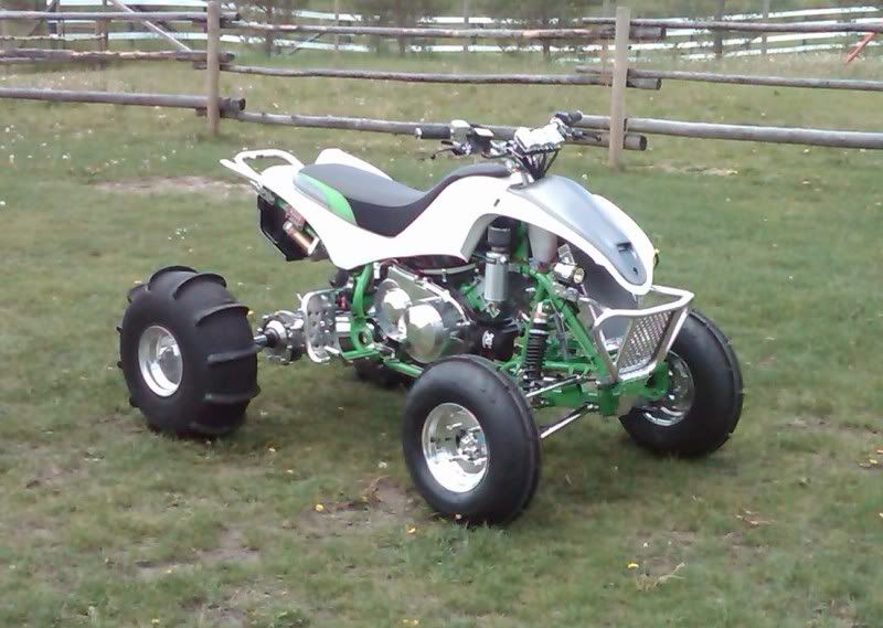

my wifes
white carbon
4

My wife's race cut CF white.
Monkey I have to say, IMO your wife's bike is the most visually spectacular bike I've seen on this site. :tup:
Yeah thats a sweet looking v monkey......but the wifes bike......come on fess up :lol:

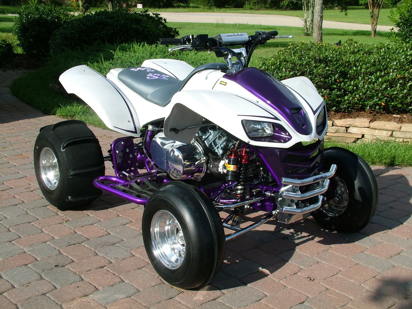

I have seen this front bumper on a few different bikes:
Is it custom or is it available to purchase from somewhere? BTW, both quads pictured are super sick!
Armadillo Makes it
Armadillo Makes it
Thank you much! Anyone ever have any complaints/problems with it?
